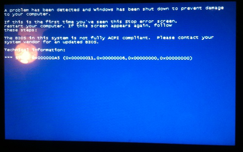

Re: Coreboot and SeaBIOS
You know I'd have to try it... an install of W7 patched to boot from USB bluescreens very shortly after the progress bar appears.
I hoped to try Dan's Windows loader, of the type that spoofs a valid SLIC in the BIOS, with fingers cross that W7 saw a more complete BIOS and booted. No joy.
Oh yeah. I know that crash. It's trying to use SMM to enter ACPI mode. Not exactly a good idea with how I've got it set up at the moment. I've already fixed that and another 2 blue screens after it. Now working on the next problem which is more of a 'hang'...Mevi wrote:You know I'd have to try it... an install of W7 patched to boot from USB bluescreens very shortly after the progress bar appears.
I've just uploaded another build (same URL), not a huge improvement, but it doesn't blue screen trying to boot Win 7 any more, just hangs instead
