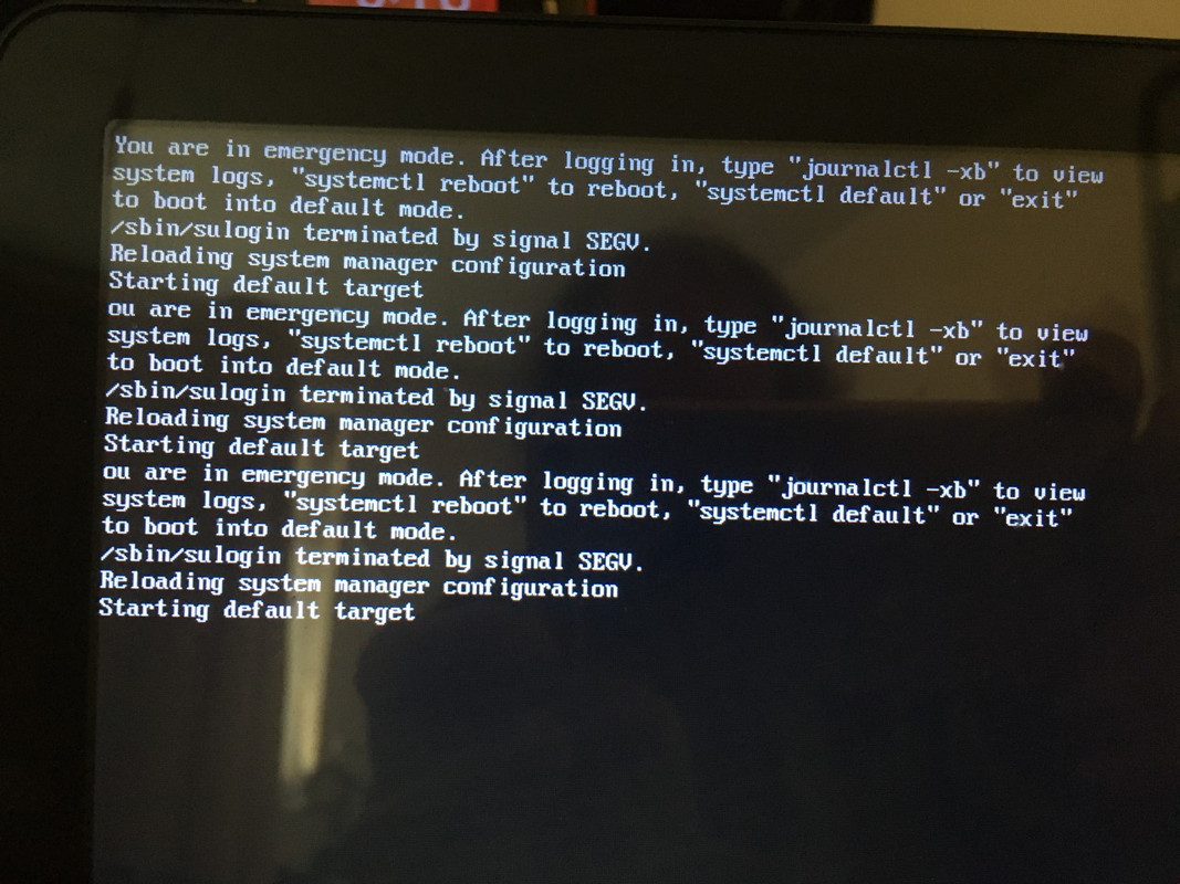

Well I would not rush with this, as this morning the Joggler would not start.
It got as far as the Squeezeplay flash screen then stopped.
After a while this message appeared
I'll try later using a usb stick
ronnie

Man in a van wrote: Wed Sep 08, 2021 11:41 am Well I would not rush with this, as this morning the Joggler would not start.
ronnie
USB working well, it fired up first thing, this morning :)
