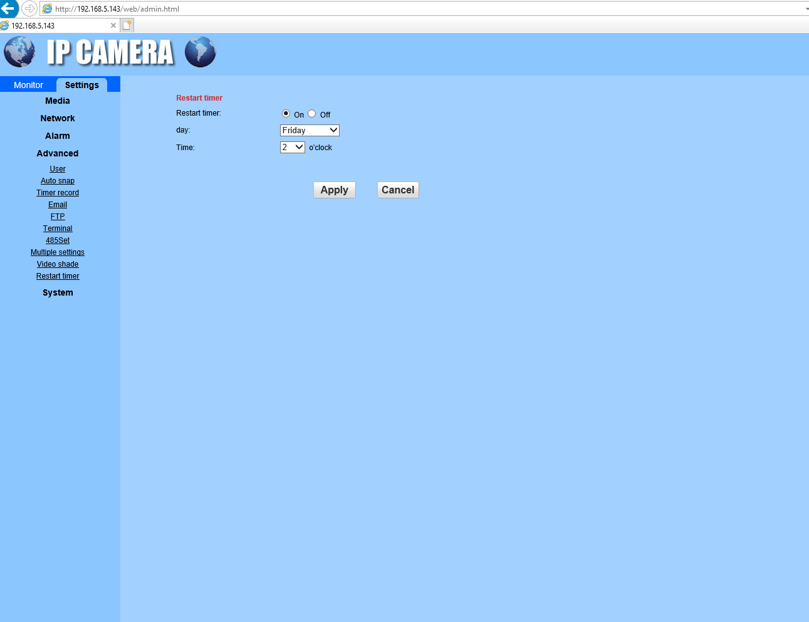

Here is a picture of the browser settings which only works in IE. Not in chrome or firefox.

Thanks, I'll check out the client demo. However, it is a bit pointless if the settings are deleted on the next reboot, as one of my modules does crash occasionally. I guess that's why the restart timer is enabled by default.
Do you normally turn off the restart timer?

Here do not have a restart timer.
