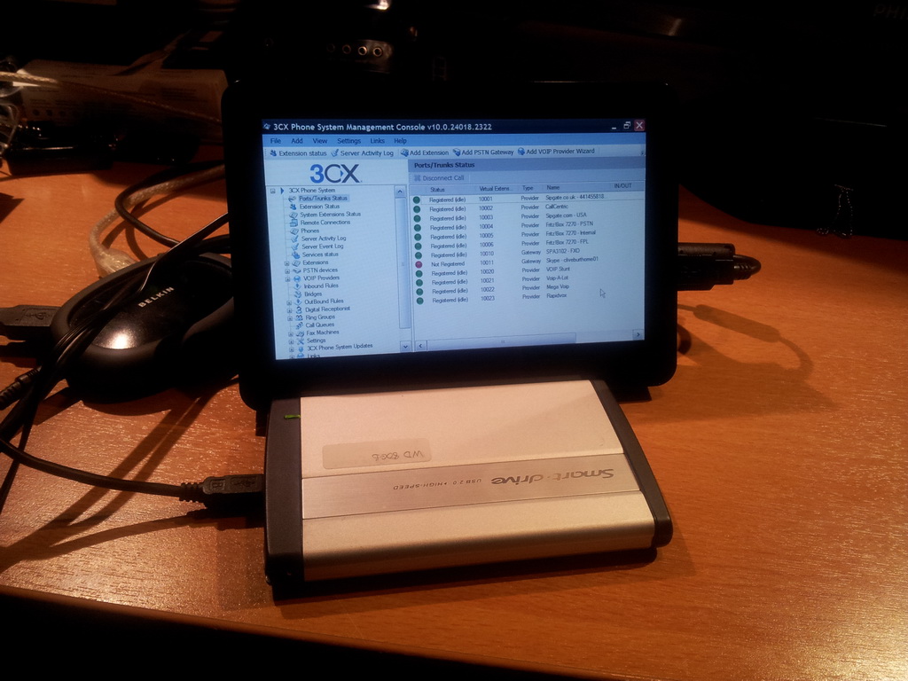

The mighty Joggler with it's 3CX PBX hat on...
Thanks to Mevi's XP build and 3CX's free version of their phone system software, I now have a Joggler PBX that only consumes 5 to 10 watts of power.
The 3CX software tries to start it's dozen services when XP boots up but only 3 of them make it, I have to start the manager console (see photo) to start the rest up. After that it runs fine.
The only thing that doesn't work is the 3CX Skype Gateway, which is a software method of getting Skype to talk to SIP.
I got around this by using the Xconnect software that came with my Xlink BTTN that I use to provide a mobile phone connection in to my system.
Still not sure if I'll use the Joggler as my "Production" system instead of my server, but the experiment HAD to be done. :D

cbredfred wrote:The mighty Joggler with it's 3CX PBX hat on...
Wow, that looks really good !
I'd love to have a go at doing something like this myself. Are there any links you have found useful, you could post ? And/or any further write-up you could do ?
Be interesting to hear what problems you had and what you did / think will resolve them. Also be good to hear how things go with this too.
