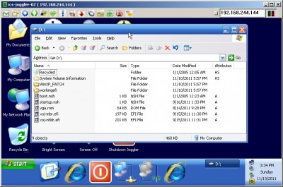

Re: RELEASE - Windows XP Professional SP3
OK so I copied the three EFI files from the oldest running Joggler to your last posted image EFI partition.
1 - Removed the NIC cable and did a cold boot. Booted up fine - no change in time to live OS.
2 - Next a warm boot. It worked! Very interesting. I only saw the O2 screen for a second or two then loaded OS. Fast boot. Went right to XP.
3 - Next I shut it down and plugged it into the 7 port hub with a keyboard dongle; just picked a port at random. Error NTDETECT failed. Moved the stick to another port. Same error. Removed the keyboard dongle. Tried again. Same error.
4 - Plugged the NIC cable in - didn't lock up first time; went right to the network.
I don't understand anymore; getting EFI confused now.
So no go for me with the 7 port hub. The difference though is that I've only used the Hub with memory sticks and not the SSD USB drive and the "in production" USB SSD its on the inside USB port.
For now will leave these three files in the EFI directory.
Here are the three files anyways; see if they are different for you; check out the warm boot thing.
