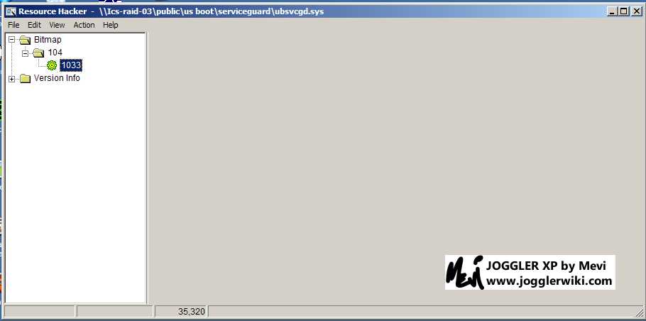

USBoot on my build, I edited one of the .exe or .dll files to remove a boot graphic that appears mid way through the XP boot. The text you describe, is that the couple of lines that you see once switching back to the original XP bootloader?
I have never had the need to remove USBoot as I'm always on a removable drive, so I cant add any anecdotal info. Aside from the USB booting, the other functions of USBoot are to make the drive portable and be able to work on other machines. There's the function of removing drivers for hardware that's no longer there, I think. The other thing the services do is to monitor certain things that, should they be changed by some process and break the USBoot, it changes them back. I remember that one of the things is to move the USBdriver to the beginning of the boot. What those other things are, you might get from the USBoot.org website.

Its not really an issue Mevi. I was just wondering which exe or dll you edited and if you would post that specific DLL/EXE?

Yes.The text you describe, is that the couple of lines that you see once switching back to the original XP bootloader?

If you are after the original dll or exe, I will have to dig around on my external HDD for that and post it another day (possibly Friday, as I am away with the kids and that will be when I get home). I will have the original backed up. The build 3 backups on the HDD are the only Joggler things I have close-ish to hand. I think I remember the one I edited had a name starting UBS instead of USB like the other files... It was just a boot graphic that I removed (I hoped to be able to replace it with something Jogglery, but that wasn't displaying for reasons unknown by me). If you watch one of Dan's builds boot, you will see that USBoot logo fade in and out.
Using either the unedited or edited versions of that dll, USBoot will still display those lines of text. The USBoot forum has a lot of requests for a method to remove the text, but the author had refused them all when I last visited.

I found the file in question. You did save a back up of the modified one. Its the ubsvcgd.sys file. Attached is your file with graphic.
I would prefer to keep your original graphic. For whatever reason there is a 30-40 kb difference in the two files and I wonder if original author is doing some sort of crc thing to keep the original graphic.
