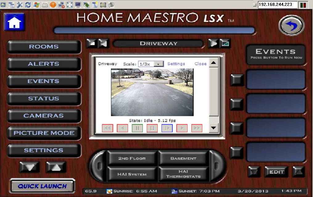

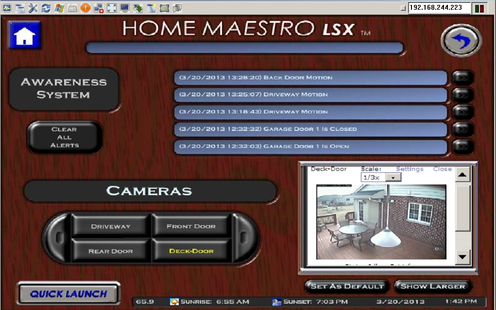

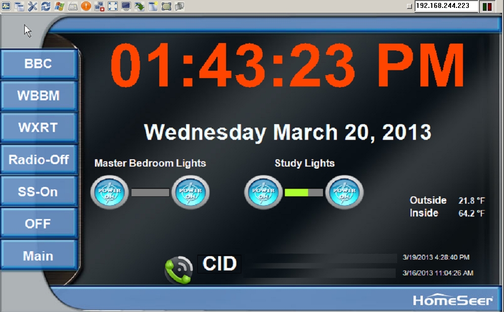

Here are some snapshots of the Joggler running Mevi's image that I am using for Home Automation stuff.
