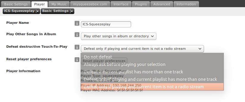

Yeah here updated per tickle on the main Squeezeserver page.
Where is the "defeat destructive select" option?
Ahh....see that it is on the squeezebox player and see this in the Squeeze server forum from the second of August...
http://forums.slimdevices.com/showthrea ... yer/page73
Thanks for the suggestion Ralphy! ...but no go. I was previously running 7.7 of LMS due to bugs I had experienced in more recent community versions, but just updated to 7.91 to see if would help with this issue. Unfortunately setting player to Do Not Defeat (or any other destructive Touch-To-Play setting) did not make any difference; I tested settings by changing another item on the player page - Play Other Songs in Album - and yes, the PiCorePlayer responded to the change.
It seems to me that the problem is related to the selected song holding touch focus during and after the confirmation "Song Added" dialogue box appears, so that a subsequent touch on the Now Playing button, while detected, does not refocus the touched area on the Now Playing button - but instead is interpreted as if the song selection was touched again. What also makes it fairly obvious this is occurring is when selecting the Now Playing button in the sequence described, the song selection momentarily highlights as if touched.
I wonder why defeating destructive touch does not seem to be working? While it wouldn't fix the bug, it would at least keep my playlist intact.

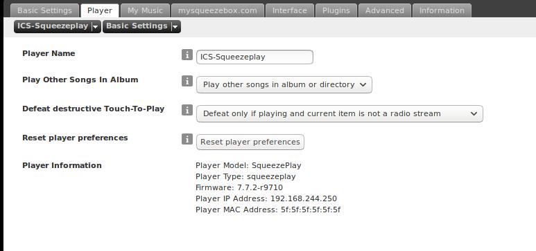

And the info relating to my Openframe 2 squeezeplayer in OS. *I have not touched the scripts relating to the MAC address. It is should the custom MAC that I installed. I would like to change it again anyhow.
Player Model: SqueezePlay
Player Type: squeezeplay
Firmware: 7.7.2-r9710
Player IP Address: 192.168.244.250
Player MAC Address: 5f:5f:5f:5f:5f:5f*
Note that the Player MAC address is the real MAC from the NIC and different from the MAC if I do ifconfig.

What do you mean by 'Player info'? - you need to check under LMS gui - Settings - Information. You'll see which version is operating there.wcndave wrote: ↑Mon Sep 18, 2017 6:31 pm Sorry, I've not been very clear, I was just wondering quickly whether anyone new about the defeat option, if I could download the old 7.8 I'd just do that...

So.. do you know how I get "defeat destructive play", on the _player_?
- Posts: 486
- Joined: Sun Aug 25, 2013 2:39 pm
- Location: Staffordshire. UK
Re: Mediaserver Debian Version
Is this what you mean?
destructive play by Man in a van, on Flickr
I have never really understood it
http://forums.slimdevices.com/showthrea ... ch-To-Play
Ronnie
Ronnie
I always just set it to Do not defeat.
Like you, I've no idea what it does otherwise.
Same here.
