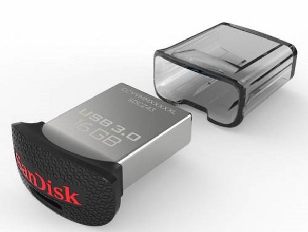

I have just installed to a 16gb Sandisk Ultrafit as pictured, it does boot but is very slow, definitely would be be better on an ssd drive.

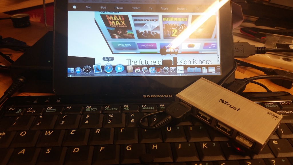

Cheers for thst Mick , I put it on a 750 gig Adata External HDD and a Trust hub but it seems to be stuck on boot screen :-( probably down to the slow speed of the HDD) Image
Re: OS X Snow Leopard on the Core Booted Joggler
Did you have a keyboard plugged in & press enter, it doesn't boot automatically.

With the Adata HDD it started to boot then crashed out , tried various combos of hubs / keyboards etc .
More success with the Ultra fit 32gig and a full size keyboard , seems to boot fine , right through to desktop then immediately crashes with this screen.
Try this
when you get the picture of the disk drive on the screen just type "-v -f -x" without the quotes and press enter
you will get loads of text scrolling and it will either boot to the desktop or crash again.

Success 8-)
