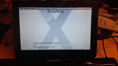

Have now got the installer USB to run on the Joggler, before I used another PC to install to the USB stick because I couldn't get it to boot on the Joggler.
Don't know if it will make any difference time will tell.
Take no notice of the time left for the install its been installing for the last 40mins
Re: OS X Snow Leopard on the Core Booted Joggler

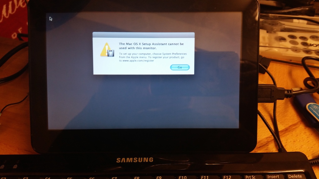

Well it took 2hrs to install on the Joggler and it boots to this screen, but it works.

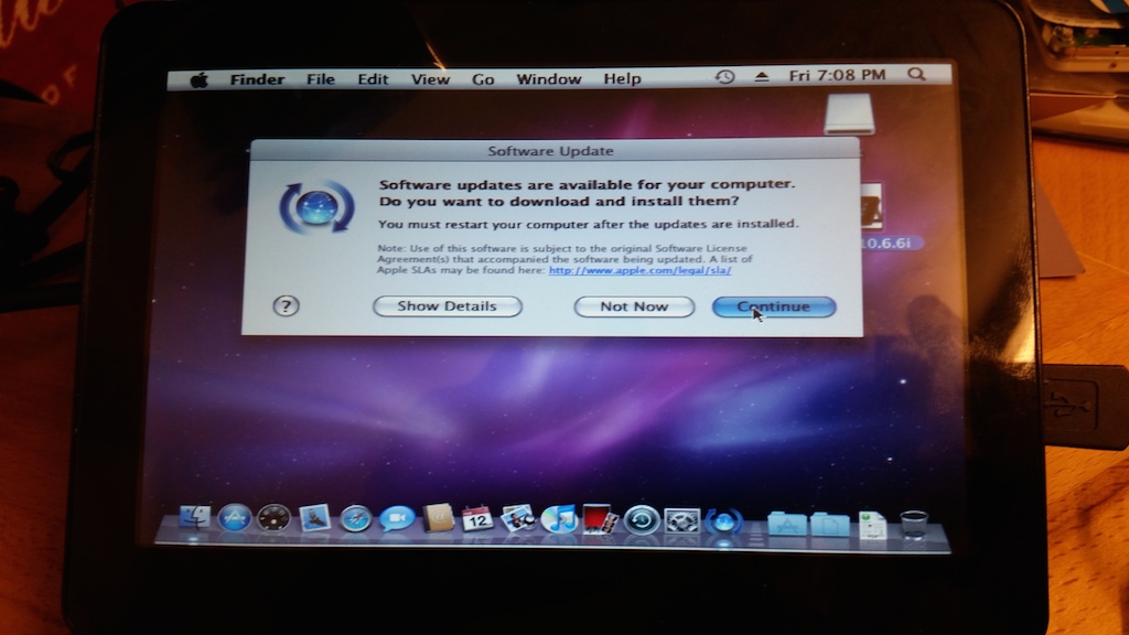

Are you getting the same crashes as me Mickchip ? Just making sure before I try to source a heat sink for my Joggler as that's what I'm blaming at the moment :-) everything seems to work but downloading stuff i.e programs won't install but do download ok .
Also wireless still not surviving re boot .

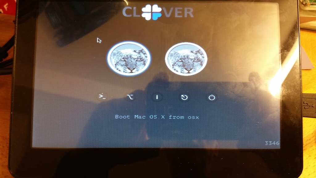

A small update, still with Coreboot/Seabios but with clover for efi boot.
I can now boot windows & OSX in efi mode using CLOVER.
Only trouble is I can't get clover to boot off the jogglers efi, will keep trying.

Took  about 8 mins to fully boot up
Edit
Now boots in about a minute after generating a CLOVER config.plist.

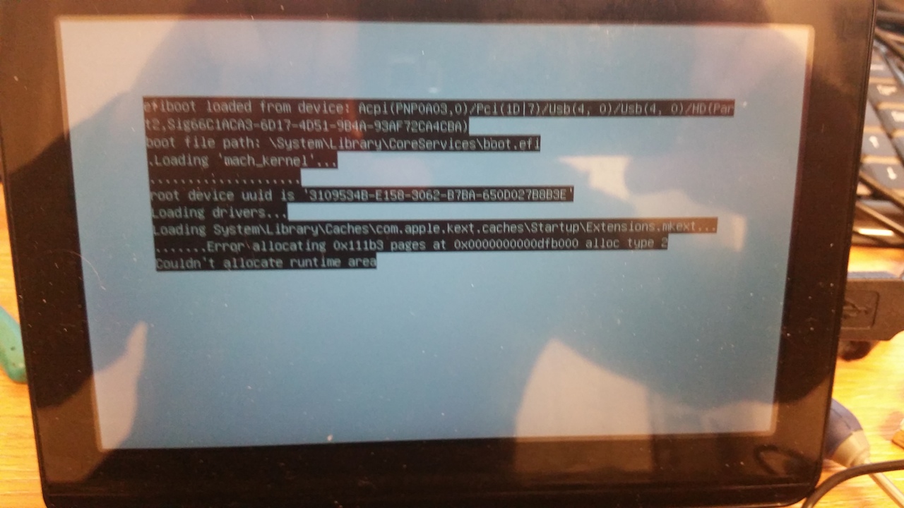

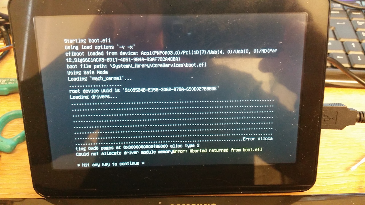

This is with Refind, booting in safe mode.
I think there is a memory allocation bug in the jogglers EFI bios.
