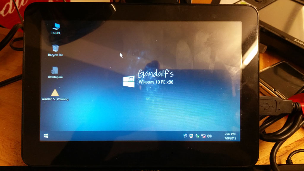

Got Windows 10 PE going on the Coreboot/Seabios joggler.
Here are the links if anyone wants to try it.
http://windowsmatters.com/2015/08/14/wi ... -usb-apps/
http://mistype.reboot.pro/documents/Win ... atBoot.htm
There are different PE builds but this is the one I used, don't know if the others will work.

Great news Mickchip , is that booting off your Sandisk ? How responsive is it ?

Thank you Mickchip!
Downloading image right now.

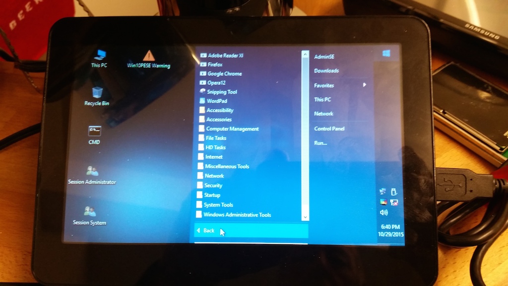

Only just installed it, Its on a kingspec ssd stick, still a bit slow but there are quite a few Apps included.
Browser has crashed a couple of times, but it has Firefox, Opera and Google chrome.
Will try to sort it, I also may try another image. It may be that I'm not sure what the hell I'm doing, it's all trial and error, try again with me, however I usually get there in the end.

Now I know why it was a bit slow, the Kingspec stick has just died.
Still shows as 30gb in diskpart but will not format and I can't read or write it.
Just tried the latest version of WIN10pe from the above site, that works OK too

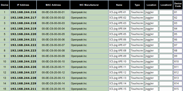

Trying to break the automation mothership. These are Wintel based Jogglers.
There are Linux Jogglers scurrying about too. (really they do not scurry).
Note that the MAC addresses are made up and not standard for Openpeak.

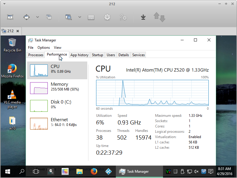

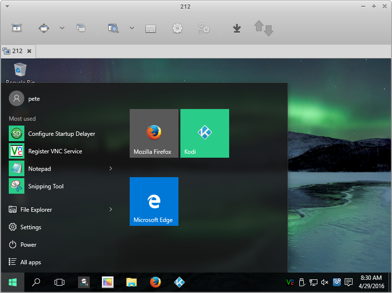

Went over to testing / playing with W8 embedded...ugg...didn't like it...
Tweaking W10 again. It is very chatty Kathy and really and truly considering it an internet terminal of sorts...even after removing stuff it keeps wanting it back....really no different than any smartphone / tablet these days...ZMNinja runs really well on it...(video seems to be better than embedded XP - maybe though it is just me?)
I could get ZMNinja to run in Ubuntu but it is not as fast as W10.
ZMNinja is a very nice touchscreen Zoneminder interface / console that runs on any mobile smart phone in any OS. I have been using Zoneminder now for well over 10 years and it does allow for any of my cameras to be configured today.
