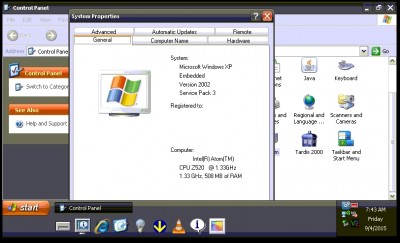

The XPe image I use is less than 3Gb today and I single purpose the Openpeak devices and they run just fine. (not off of USB though).

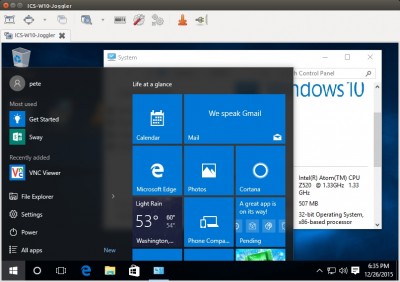

VNC works better on W10 than W7 or W8 and will post some screen shots. It did immediately connect to the MS mothership in the cloud, updated itself and all of that metro stuff. I also installed my sapi voice fonts on it (Neo Speech), screen savers et al.

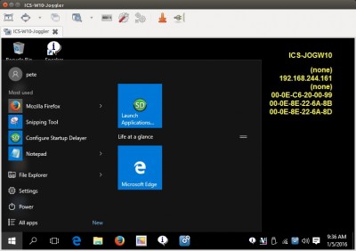

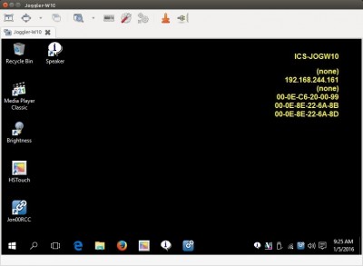

Now that I have the compact W10 build working here moved it to another Joggler. I write the Seabios boot bios to a new box and connected the SSD ZIF Pata drive with W10 on it. Odd (from personal experience) that it booted right up and the Gb network port also worked just fine from a cold boot.
This particular build is using a more compact USB WLAN stick instead of the stock USB WLAN stick.
It is very basic now stripped down version of W10 Enterprise. I have it down to 8Gb which is still kind of big.

I did create a boot W10 stick and was able to use it to install W10 on the PATA SSD hard drive. That said all of the current releases of W10 will not recognize or see the USB medium as a boot drive. I have never attempted to try this with the original EFI boot rom.
Noticed yesterday that most current release of W10 / winlite scripting creates a build that doesn't start W10. IE: MS did the doo relating to modifying the install such that I cannot remove services prior to final installation pieces. I have gone back now to an earlier build and not wasting my time with this this as I tried many times yesterday.
BTW post install lets you disable most services but doesn't let you remove them. Basically here just trying to keep Edge and Windows store. Thinking this might be an issue relating to removing cortana. It appears that there are many dependencies of the internet to the OS. (very cell phone like and similar to Android).

Another thing I just noticed with the most current installable version of Windows 10 is that once you follow the MS prompts connecting wireless and talking the MS cloud; it sort of disconnects you from making changes to your wireless stuff. I mean I can see the drivers but I cannot change to a different access point.
So I started again this time using the Joggler wireless connection. Disabling it and then using the Gb connection which is easier to control / manage.
All of this though makes me want to go back to just using the W7 embedded OS and maybe later on entertain using W10 for my touchscreen stuff. I will though run what I have made and still try to disconnect it from stuff I do not need.

I am done playing with it on the Joggler / Windows 10. I got it thin for a time. Then I noticed the updating after installing the most current version downloaded deletes my changes and software adds turning the Joggler in to a tablet / smartphone / internet terminal.
I would say though play with it and see how it fits. Going back here to using Linux / 7e / Xpe for the time bean and relating to my automation consoles.

Playing some more...and I do not know why....I have already written that I am not going to play with this anymore....
Found out how to remove a bunch of internet services running .....and removed them all....
Upon reboot for whatever reason....W10 repaired itself...using MS internet drivers....first thing I noticed though on a long reboot was that W10 shut off all of the installed drivers except for the internet stuff...(keyboard and mouse stuff bugged me).
A couple of W10 repair reboots and my keyboard / mouse came back along with all of the internet services I removed....
I am guessing I just don't know how to do this yet ....W10 doesn't want to let go....noticed too I cannot modify the mac addresses and it keeps adding more so it appears to be finding ways to do this...here I manage the devices on the network based on mac, network address, name (all three)...wouldn't work changing the IP to a static address so I went to assigning a static IP via the DHCP server on PFSense which sort of works now. I removed Cortana and I think that it stuck...left Edge and also removed the MS Store (think that stuck too?). The more I remove the faster it gets.
