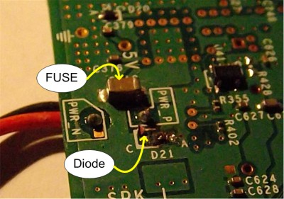

Yeah its tiny. Easiest way to tell is to look by the main 5VDC inputs for something that looks like an insect that got toasted and is laying on the board. Use a magnifying glass as I saw scorch marks on mine.
Here is a picture of it.

Here is a picture of my test Openframe board. It is working fine.
Here I changed the diode rather than the fuse.
When I first did this my soldering skills were piss poor. That said I have only had to do this once so far. I would recommend the proper tools (which today I have).
This is though like using the oven to heat up and melt a PC board which here was done only once and very low on the WAF.
It is not difficult. I use a magnifying glass today with tiny stuff and it works well. You can too just by pass the fuse and put a little wire in place (but I wouldn't recommend it).
The fuses/diodes were purchased in a bulk pack for around $1 USD with free shipping.
The fuse is on the upper left and note that the diode is marked C(athode) and A(node). It is smaller than the fuse.
Apologies as I didn't notice until I just took a picture of it.
Yeah and I also purchased little SMD diodes along with the fuses for other stuff. SO have a close look to see if its a fuse or a diode that burned out.
The scorch marks near the current diode picture were already there. I did make the marks worst though.
The above noted it could be either the fuse or the diode. I have seen both issues with the Joggler.

Re: Wrong Power supply bricks device?
Nice pics Pete !
The fuse looks a lot bigger then the diode, so it should be easier to replace or even go for the fuse off the board solution.

Note the picture I posted above is of the underside of the belly of the Joggler. You can just check continuity of the fuse with a VOM if you want. I suggest you replace the fuse if you do not see any continuity. That said thinking I did a bad thing on one Joggler just doing a solder bridge and not installing a fuse on one of the ones I had. Just have to remember never to plug in something other than the 5VDC.

The fuse is connected to the red power input wire and a direct trace on the other side of the red wire. It is the same for the O2 Joggler, Openframe 1 and 2.
Best to check voltage with a VOM.

That does look quite different from the one Pete posted , if you look at the numbering say C376 as a reference , will that help locate it ? I did this to one of mine and gave up in the end , bought a broken one with a good screen .
I think the idea is if you test either side of the fuse , you should see a loop , if not it's blown and a blob of solder bridging the two points would repair but then obviously no fuse for the next mishap :-( .
