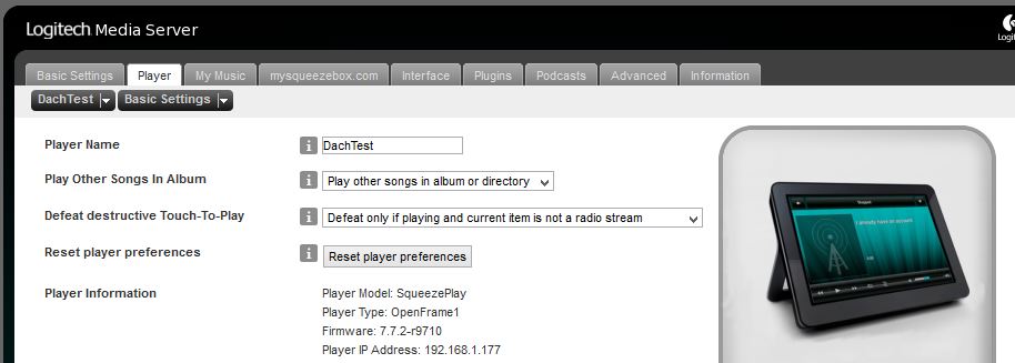

palindrom
Posts: 67
Joined: Mon Jan 27, 2014 4:14 pm
Re: SqueezePlay OS (Version 3) for OpenFrame
Post by palindrom »
castalla wrote:If anything, I'd suggest the default squeezeplay name be Jogglerplay. I have a variety of squeezeplay setups (eg. a windows one, at the moment) and it's always better to assign a unique name otherwise it can get very confusing.
I totally agree "it's always better to assign a unique name".
Just keep in mind that there are 3* identifier (Name/Model/Type) for a Device which are generally called "Name" within discussions.
* 5 identifier if you count the IP address and the MAC address as well
See my Screenshot.
Model: SqueezePlay
Type:  OpenFrame1
Change the Name to your liking.
I would not change the Model, because it's (still) a SqueezePlay implementation.
But I recommend changing the Type according to the HW Platform.
(Currently the default type for SqueezePlay is SqueezePlay)

Posts: 1746
palindrom wrote:Change the Name to your liking.
I've been having a play with this. It's quite amusing; the variables and labels have obviously become confused at some point. In the settings:
name= gives the 'Player Name', as in, the identifying name the user gives that player.
model= gives the 'Player Type', as reported in the nightly-build versions of LMS. That's the one we'd like to tweak.
Goodness knows what gives 'Player Model', because it's not in the preference files. But that's fine, we want to leave that as 'SqueezePlay' anyway. :)
Ding! Ah, that may well be the ID number... so, ID = model, model = type, name = name. Simple! :lol:

Ah, are those icons for the OpenFrame devices still around anywhere? They can go into v1.60, if that's okay with you, palindrom. :)
I am happy to provide the new icons (improved quality)
Open Frame 1
Open Frame 1
Included in LMS 7.9 nightly build distribution
Open Frame 2
Open Frame 2
