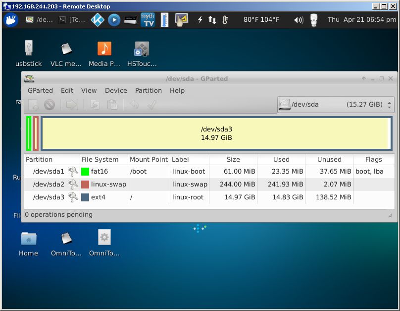

Re: Plex Media Server on the joggler
Yeah here started my test Joggler with Buzz's Ubuntu at 16Gb SSD. I have expanded the root now to the internal MMC (1Gb) and a 4Gb USB stick. It is not enough.
Just my /home directory on my test Joggler is over 6Gb. I would personally start maybe with a 32/64 Gb device, use Buzz's Ubuntu 14.04 desktop build, add LMS then add Plex.
Buzz's primary desktop build is around 8Gb. Expanding it to 16Gb is easy. I typically expand it before running it the first time.
You can just remove the stick and use GParted on another computer to resize it or use a Live Ubuntu Boot to use GParted on another computer.
I use minitools partition manager typically only for windows builds.
Here is a Gparted look (can't change it though). Here I was just going remove the SSD and use GParted to copy the 16Gb SSD to a 64Gb SSD then expand it.
