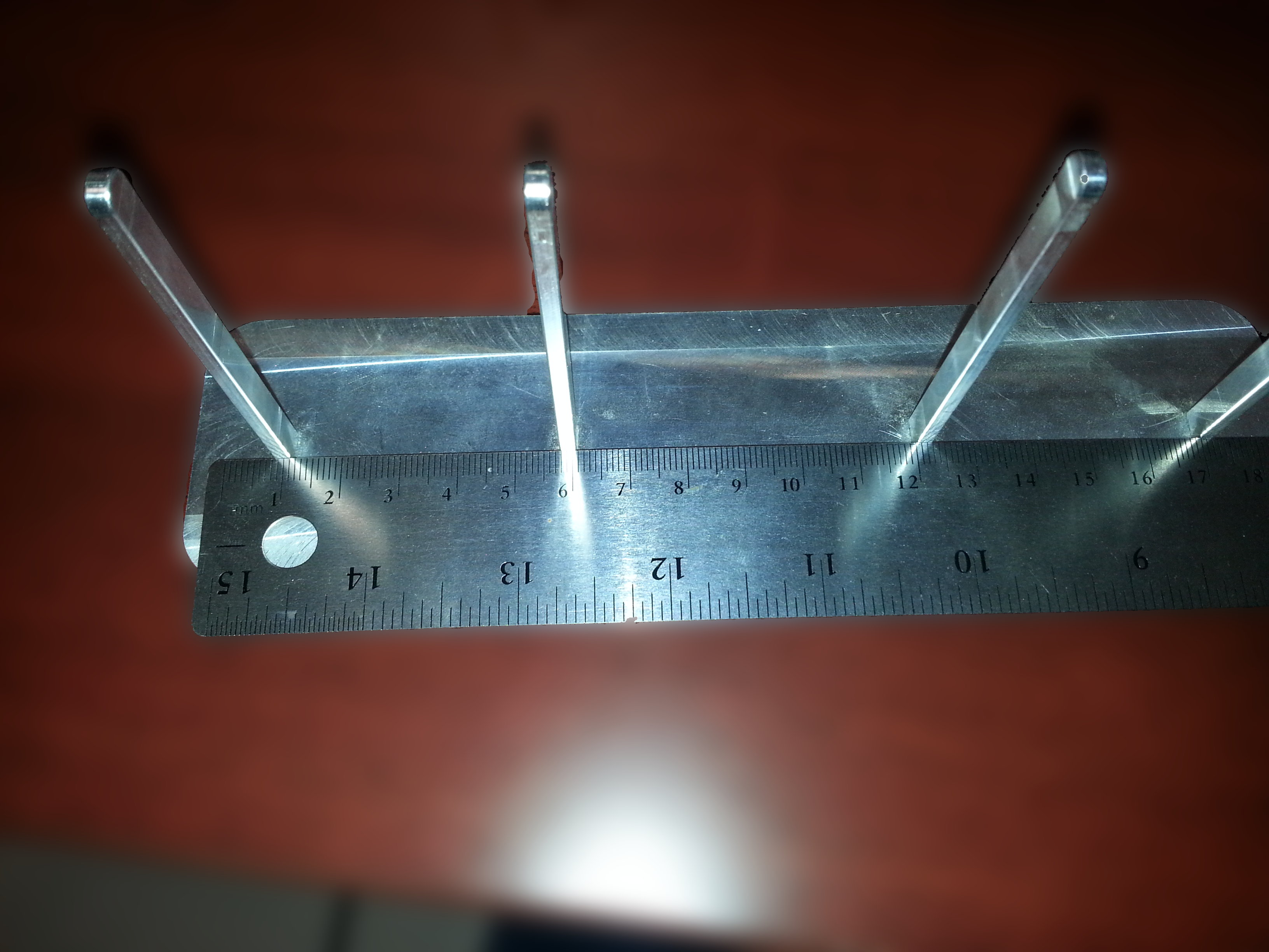

Just to mention - I have photos of the tool to remove the back from an openframe 2 (next to a ruler). I need to process them a bit and they will be put on the wiki.

Just a guess from what I did here butchering my "broken" Openframe 2. The four bottom holes align with 4 plastic tabs on the bottom of the LCD plastic frame. Pushing on the four tabs at the same time and lifting the LCD frees it from the housing. Is it made of metal or is it a plastic device? Right now the Openfram device is all apart and I used painters masking tape to keep it together a bit laying the large metal heatsink on top of the taped together what was left after butchering device. I am looking at soldering the fuse back on the Openframe device. Its so small though I worry that if I sneeze when getting ready to solder it back on to the main board; it'll go flying some where and I will never find it. (I did purchase 2 of them; but they are maybe 1/20 the size of my smallest fingernail - small insect looking)

pete_c wrote:Is it made of metal or is it a plastic device? Right now the Openfram device is all apart and I used painters masking tape to keep it together a bit laying the large metal heatsink on top of the taped together what was left after butchering device.
Metal - Looks like

It is a clear run from the four holes on the bottom to the little tabs that hold the LCD in place; such that pushing on the four tabs together and lifting the LCD would be easy.
I will take a picture of the four plastic tabs under the LCD mount that need to be pushed up to lift out the LCD. Each tab is about 1/2 " wide. Looking at them a bit they are maybe 1-2 mm above the edge of the LCD. The LCD has a rubber surround which makes it fit tightly into the plastic frame. Only the bottom four tabs keep it in place though.
The metal speaker cover is kind of wedged in place with no clips holding it in place. I bent mine pulling it off though.
I think though if you wedge a little plastic stick right below the tabs and lift the LCD carefully you can remove the LCD to get to the insides of the case. That said under the LCD are the screws that hold the rest of the case / motherboard together.

That pic is very handy to see - sturdy frame with rounded edges to the prongs... I can see how it works now, very straightforward. :)

Goofing around a bit with another Openpeak II today. I found it easy to pull off the LCD screen by using very thin plastic where the tabs are at that hold it in place. Once one tab is released the rest come off very easily.
After removing the LCD then its just removing the screws that hold the plastic case on. The little plastic Openpeak logo piece above the speakers lifts right out. Then its just one screw that holds the motherboard in place.
