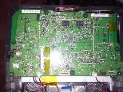

It did have a similiar combo wireless/bluetooth mini pcie card; not marked with the broadcom name though; looks similiar.
It also looks like the power supply burned out the board at one time as it is scortched there similiar to my other Open Peak 2 device (that was broken and I fixed). I did have it working with XBMC on it; tried to update it yesterday and trashed it. Not a big deal to write over it.
Pictures will be posted. I am trying to open another Openframe 2 one in a similiar fashion. Really its just pushing on one of the four tabs; then "lifting" the LCD at the same tab; then the rest of the three just unclip. Its all plastic.
Paying attention a bit and noticing that the audio chip is different on these than the O2 Jogglers and it is giving issues.

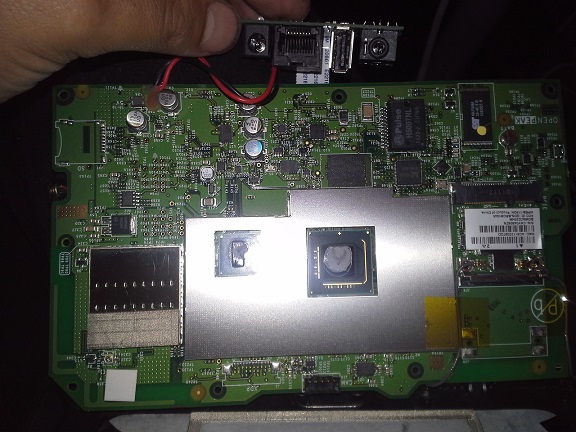

Here are some pictures of the Openframe 2 device that I opened. I removed the wireless / bluetooth card as I am experimenting with the socket.
Easy to open once figured out.
I utilized one long thin screwdriver pushing on the 3d tab (one of two center tabs). While pushing on the tab I took a thin plastic tool (?) and lifted on the LCD there. I wedged it and left it there moving to the other tab areas of the LCD doing one at a time and putting in a spacer while moving to the next one. Last spacer in I could easily lift the LCD. The plastic trim piece and speaker grill just lift right out as they are held in place at the top by the LCD. Once you have lifted off the LCD there are a bunch of screws that hold the plastic front cover to the back cover. Removing these you get to the motherboard. There is only one screw that holds the motherboard in place. It is very well built. What is nice about these is that the back pivotal stand removes and you can hang this device on the wall with maybe a small VESA mount. The audio, USB and NIC jacks are angled and a bit inside of the rear case giving you a smaller mounting footprint. There is a removable plastic cover on a 5 pin connector (USB port) on the top marked for a web cam. That said this would be a nice skyping with webcam, device.
It is different with the socketed EFI boot chip and the desoldered Zigbee stuff. There was no DECT stuff on the motherboard. I am thinking that maybe this was an experimental to O2 board provided by OpenFrame for initial O2 Joggler testing? It does have a CMOS or clock battery soldered to the motherboard. It does also have a different audio chip on it than the O2 Joggler. Interesting that the updated o2 firmware doesn't play sound using PnP3 but does play sound with the original included OS. I noticed that when I used the base build of Ubuntu and did an update it picked up the sound drivers.
I did try XP with seabios on it. The NIC didn't work no matter what I tried. I also had issues with this one relating to no sound in XP.
A couple of days ago ordered the older style mini PCiE broadcom HD video board that used to be utilized for laptops. I am looking just to see if it'll stream 1080 a bit faster with this board. (curiousity mostly)
The board has the SIM traces as the other one has (that was butchered). It also has the PATA ZIF and SD card traces as the other one has. It appears to also have been repaired because of the burn marks by the 5VDC power in on the motherboard.
I did install XBMC on the base Ubuntu build (thanks Buzz!) and sound and NIC work well. Only thing is that it is now at 100% capacity of the built in 2Gb MMC.

Here is when i opened mine to have a look inside :
Looks like I have the empty slot for Simcard and pata,Dect and lpc cpnnector.. not sure what this is.
Would be nice to be able to get a sd card reader soldered on there, but I have no idea how i can solder stuff that smal.
What is this xdp ment for?

Re: Open Peak Devices
parrafin23,
How did you open your case?
Yeah the mini pcie card is a combo bluetooth and wireless card. You can also replace that with a Broadcom Crystal HD card for streaming HD stuff.
The SD card traces are for a standard mini SD card. The ZIF would work for a ZIF SSD card. I do not know what the DECT plug is for.
LPC - Low Pin Count connector - provides low speed legacy I/O
http://www.rtcmagazine.com/articles/view/101109

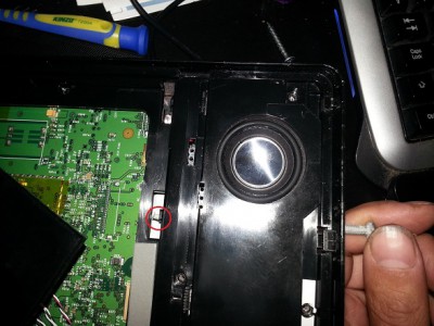

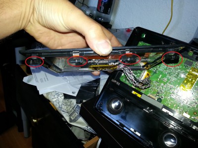

Pete.. I can take some pictures of the tool(s) i used.. pretty simple i might add. i used a nail, with the size 3,4mmX95mm 9,5mm is the length of the nail.. i used 4, one for each hole.
The red rings shows the ones that needs to be pushed up for the screen to be released. I started in one corner, put 3 nails in and the screen started to release.i used a realy smal flat screw driver to hold the screen outwards
going for the last locking tap, i had to use a bit forcre, allmost too mutch. but be care full, cause that long nail do hit the pcb The only thing i can see will get damaged is the connector to the lcd if pushed too far in. with these nails i had to push it allmost all the way in.
So this is how i opened it.
