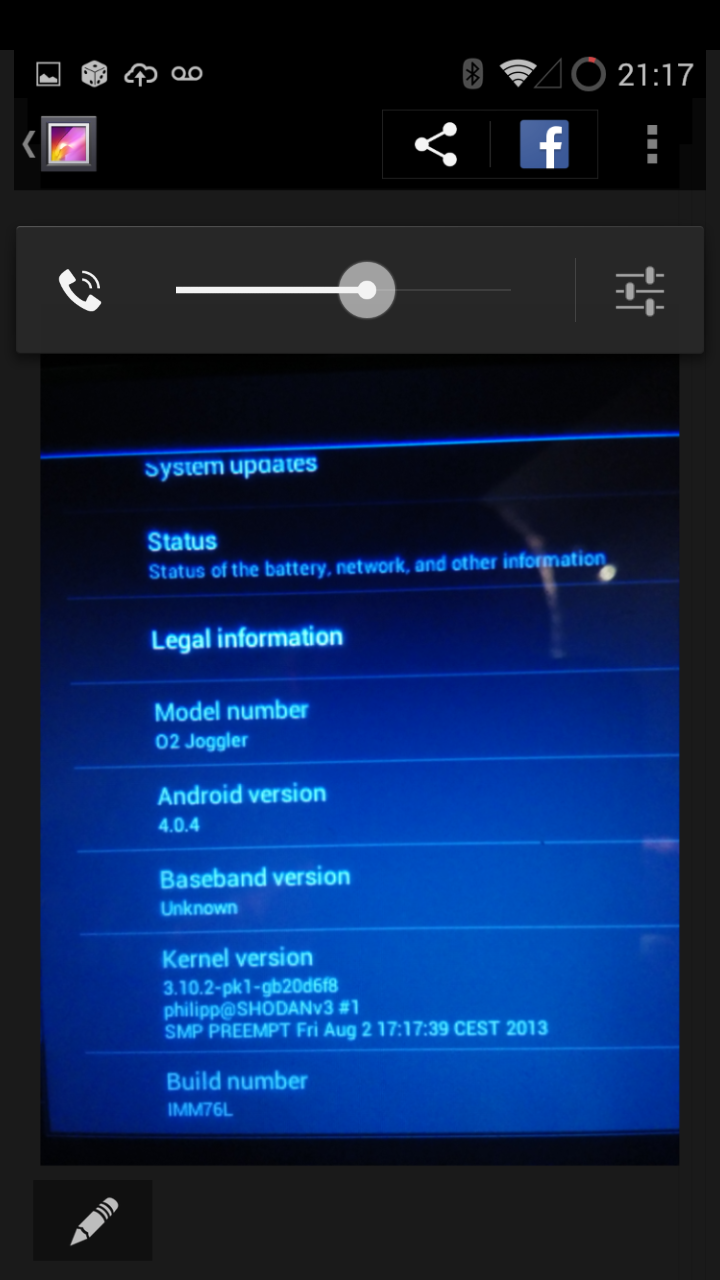

Can you just check this is the version you have DWL and cheers Nova Launcher looks much better :-)
Sorry I think its a bit blurry

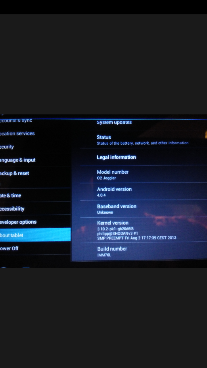

This is better

Can you tell me the build number? It's too blurry to read.
Posts: 2069
Re: Android 4.0 crashes when external speaker powered off
IMM76L
Yep, that's the one. What size is the disk image you have? It may be too big to upload to Mediafire etc. The one already posted is much smaller as it's had all the empty space removed. I don't know how to do this!
