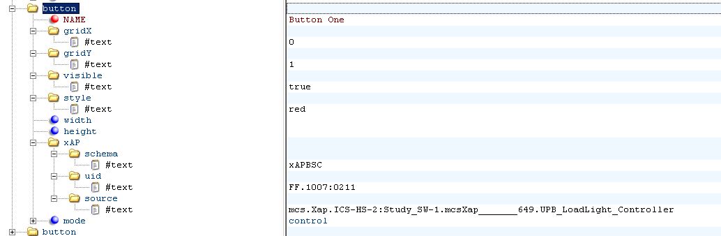

Hello, yesterday I was playing with xAP, I tryed to let it communicate with my devices, (just a simple web server!), I'd really like to know if there is a way to use xAP to send a http request when I press a button!
I created a button with the standard code:
<button NAME="testing button">
<gridX>0</gridX>
<gridY>0</gridY>
<height></height>
<style>red</style>
<visible>true</visible>
<mode>text</mode>
</button>
then I inserted this portion of code:
<textbox NAME="antani">
<text><![CDATA[<img height="150" width="150" src="http://192.168.1.10/test.html"></img>]]></text>
</textbox>
I tried to set it as a toogle too, with "on" and "off" status, but (obviously) it doesn't work... I just tried to take a piece of code from the textbox tag, the only one seems to parse html calls...
I googled a lot but I really wasn't able to get any info, is there anyone so kind to help me?
Thanks a lot!

I think I got as far as installing I-Server for the FlashxAP. I did though configure the Joggler flashxAP with multiple temperature and rain guage stuff as I was testing it. I got as far as making larger fonts and centering them for my text stuff. I think I tested a button or two.
The methodology was different relating to the structure of the xml. I mean the groups were all there; I just didn't know where exactly to put in the commands for the xAP stuff. Yes the instructions are lacking.
I am running today a little application on Arch Linux talking xAP. It is though written in Mono though using VB. Its on a Seagate Dockstar with an ARM CPU and maybe 512 Mb of memory.
Here is a temperature view:
<page NAME="Page2">
    <group>main</group>[attachment=0]sprinkler.jpg[/attachment]
    <visible>false</visible>
    <button NAME="temp1">
      <gridX>2</gridX>
      <gridY>0</gridY>
      <label>
        <text>Outside</text>
        <fontcolour>0x000000</fontcolour>
        <offset>-20</offset>
        <fontsize>20</fontsize>
      </label>
      <bsctext>
      </bsctext>
      <style>outside-temp-icon.png</style>
      <xAP>
        <schema>xAPBSC</schema>
        <uid>FF.0005:0039</uid>
        <source>mcs.OneWire.ICS-HS-2:xapmcs1Wire_Side House Temperature-June.6B000000E772F326.Temperature.1</source>
      </xAP>
      <mode>text</mode>
      <hide>state</hide>
    </button>

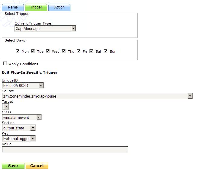

In the windows set up it is totally different and a little bit user friendly (see attached).
The Arch Linux is actually a port over from the Windows version; all browser based. See attached.
