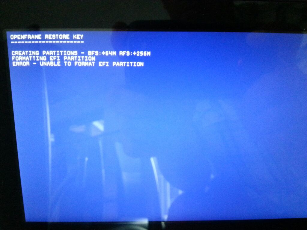

One of my Joggers just died.
Was running PNP III and became unresponsive and then wouldn't reboot.
Tried to re flash with the Open peak reflasher and got the attached error.
Is there any hope?

Try Roobarbs reflash tool? Sometimes one works and not the other ....

Yes, there is hope! I had this problem and fixed it! I first tried roobarb's reflashers (old and new) with no success.
I had to use a Linux image with a complete clean image of mmcblk0 on it.
I then wrote this via dd command.
The Joggler booted into the class is o2 stock OS (but the very original version - I guess it booted from the recovery partition as I've used this image to restore the final o2 stock OS before.
I was then able to reflash as before.
Hopefully someone will have an original mmcblk0 uploaded. If not let me know and I'll try and upload one next week.

If you want to 'quickly' test whether your internal memory is okay, you could use the instructions on my site to flash the SqueezePlay OS, as this uses dd to write to the internal memory. Then give the OpenPeak reflasher another shot - it should recreate the partitions, as the SqueezePlay OS uses a different arrangement, which the OpenPeak tool should detect and 'put right'.

It seemed to work but won't boot.
It went through things but the screen is distorted so the screen is difficult to read.
It says that it should take 5-7 minutes to flash but takes about 10 seconds and says finished so I assume something is going wrong.

Managed to squint through the fuzz and before it get's to the reflash section there are some MMC errors.
Re: Oh dear :(
It does sound like the eMMC (flash storage) is knackered. That it boots off the side port is some consolation, I guess. Sadly, the factory OS won't boot from USB, but there are quite a few alternatives for you to try.
