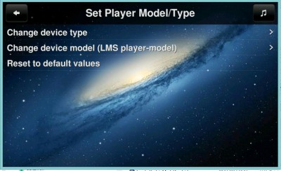

THX roobarb! this finally solved the backlight problem(s) (Brightness and Standby).
If you are creating a new release, please consider adding the JogglerUpdateModel applet too.
This app will identify our Joggler(s) as being an OF1 or OF2 device to the LMS which is essential for server-side applets.
S1
S1
S2
S2
S3
S3
JogglerUpdateModel.zip
JogglerUpdateModel
(3.4 KiB) Downloaded 222 times

palindrom wrote:If you are creating a new release, please consider adding the JogglerUpdateModel applet too.
I'll have a look at this too. To be honest I feel this is something it should handle automatically... I'll see if I can tie it in somewhere.
What does this mean?
The player type can be used to display the according OpenFrame1/2 image within LMS Settings.
The nightly build of LMS supports showing the Player Type.<br />Where all versions use it to display the according Player Image.

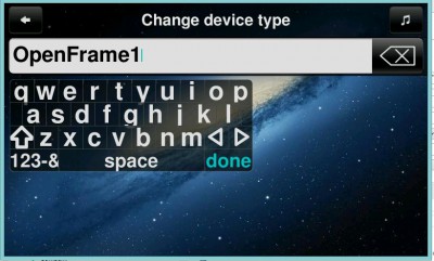

roobarb! wrote: I'll have a look at this too. To be honest I feel this is something it should handle automatically... I'll see if I can tie it in somewhere.
That would be my preferred solution too. The applet is just my workaround.
Please consider only to change the Player Type (=model) not the Player Model (=modelname) which should stay SqueezePlay.
Examples:
Player Model: SqueezePlay
Player Type: OpenFrame1
Player Type: OpenFrame2
Player Model: Squeezebox Radio
Player Type: baby
So what do you mean by 'essential for applets? It's just a picture. no?
